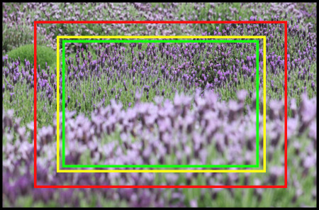

http://digital-photography-school.com/blog/crop-factor-explained/
Black - Full Frame
Red - 1.3x Crop Factor
Yellow - 1.5x Crop Factor
Green - 1.6x Crop Factor
